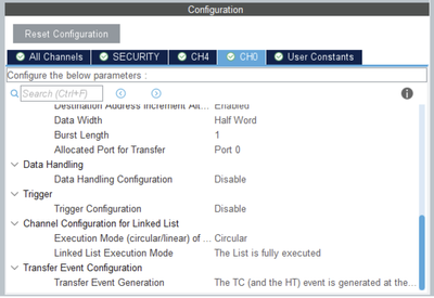

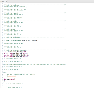

When configuring a DMA channel in Circular mode with the LL code generator for STM32H523, CubeMX generates code that correctly allocates the LL_DMA_LinkNodeTypeDef as a global variable as shown below
ensuring it remains in persistent memory and accessible to the DMA hardware throughout operation.

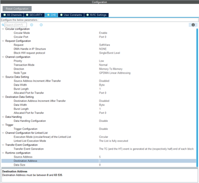

Regarding the source address, destination address, or block length for the link node ,CubeMX allows users to set these values in the GUI under "Runtime configuration," and if valid values are entered, the generated code will include them.

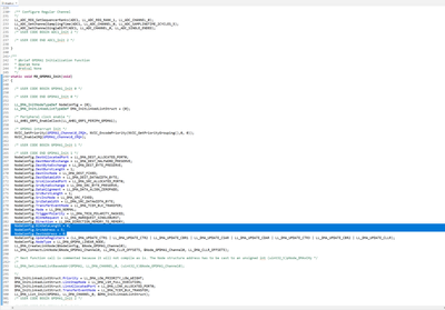

2025-10-27 9:32 AM - edited 2025-10-27 9:45 AM
Hi @Ghofrane GSOURI ,
Thank you for your reply.
Unfortunately, my experience differs. I’ve attached the generated adc.c file, where Node_GPDMA1_Channel0 is declared as a local variable.
Below is a snippet from the code.

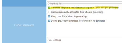

Edit: I’m using the following option, which causes the difference:
Regards,
Peter

Hello @Ghofrane GSOURI ,
Thank you for your reply. I noticed that the Source Address, Destination Address, and Data Size fields become visible when the Software Request option is selected. However, in the case of an ADC request, these values should ideally be set during the creation of the linked list to avoid having to fill them in manually later in the generated linked list node. It would be very helpful if a USER CODE section were added just before the LL_DMA_CreateLinkNode call.
NodeConfig.Request = LL_GPDMA1_REQUEST_ADC1;
NodeConfig.UpdateRegisters = (LL_DMA_UPDATE_CTR1 | LL_DMA_UPDATE_CTR2 | LL_DMA_UPDATE_CBR1 | LL_DMA_UPDATE_CSAR | LL_DMA_UPDATE_CDAR | LL_DMA_UPDATE_CTR3 | LL_DMA_UPDATE_CBR2 | LL_DMA_UPDATE_CLLR);
NodeConfig.NodeType = LL_DMA_GPDMA_LINEAR_NODE;
/* USER CODE BEGIN ADC1_Init 1 */
/* Add a new USER CODE section here to initialize:
* NodeConfig.SrcAddress =
* NodeConfig.DestAddress =
* NodeConfig.BlkDataLength =
/* USER CODE END ADC1_Init 1 */
LL_DMA_CreateLinkNode(&NodeConfig, &Node_GPDMA1_Channel0);
LL_DMA_ConnectLinkNode(&Node_GPDMA1_Channel0, LL_DMA_CLLR_OFFSET5, &Node_GPDMA1_Channel0, LL_DMA_CLLR_OFFSET5);
