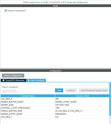

The picture below shows the "User Constants" section on CubeMX:

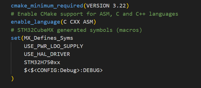

But they are not generated in CMakeLists.txt for CubeMX, as it should (according to Copilot):
Is this expected behavior or is CubeMX failing to include those symbols in the CMake file? Is there anything I need to select on CubeMX for it to generate these on the CMake file? Maybe Copilot is hallucinating?
