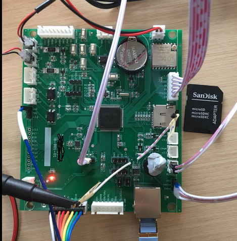

I have my custom board based on STM32F401xx cpu and my old SDIO+DMA+FATFS+FreeRTOS application developed with STM32CubeMX v4.0 and
STM32F4 Firmware Package v1.0 that runs without problems, reading and writing files on a SD card.
Now I have to develope a new application on the same board. I decided to start my new project withSTM32CubeMX v4.0 and
STM32F4 Firmware Package v1.0, the last released versions.
Testing SD card accesses with the new created code always fails in the f_mount() function, because anSD_TIMEOUT event (30 seconds) occurs.
Then I followed the excellent help of
bardeenlai
, I use the same settings in my STM32CubeMX project for SDIO, FATFS and FreeRTOS, but f_mount() always fails for theSD_TIMEOUT event.The generated code just includes the callback functions at the end of
sd_diskio.c source file, but again there is still somethingwrong/missing in the generated code.
Should I useSTM32F4 Firmware Package v1.0 to solve my SD card issue?
Should I keep usingSTM3
2F4 Firmware Package v1.0, waiting for SDIO+DMA+FATFS+FreeRTOS handling to be fixed?
