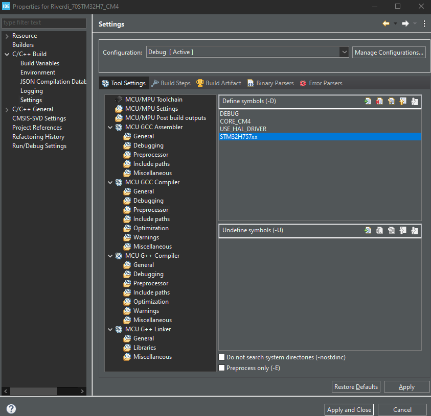

2025-05-23 3:27 AM
The newer IOC version had the wrong symbol in preprocessor, the solution is to change the STM32H747xx to STM32H757xx in Project properties -> C/C++ Build -> Settings -> Tool Settings -> MCU GCC Compiler -> Preprocessor -> Double click on STM32H747xx and change it to STM32H757xx.
I think this issue is only related to creating a project for the riverdi 7 from touchgfx inch display using the riverdi custom configuration 70STM32H7 v4.1 and probably all versions above v3.0. Riverdi knows of this.

2025-05-23 3:27 AM
