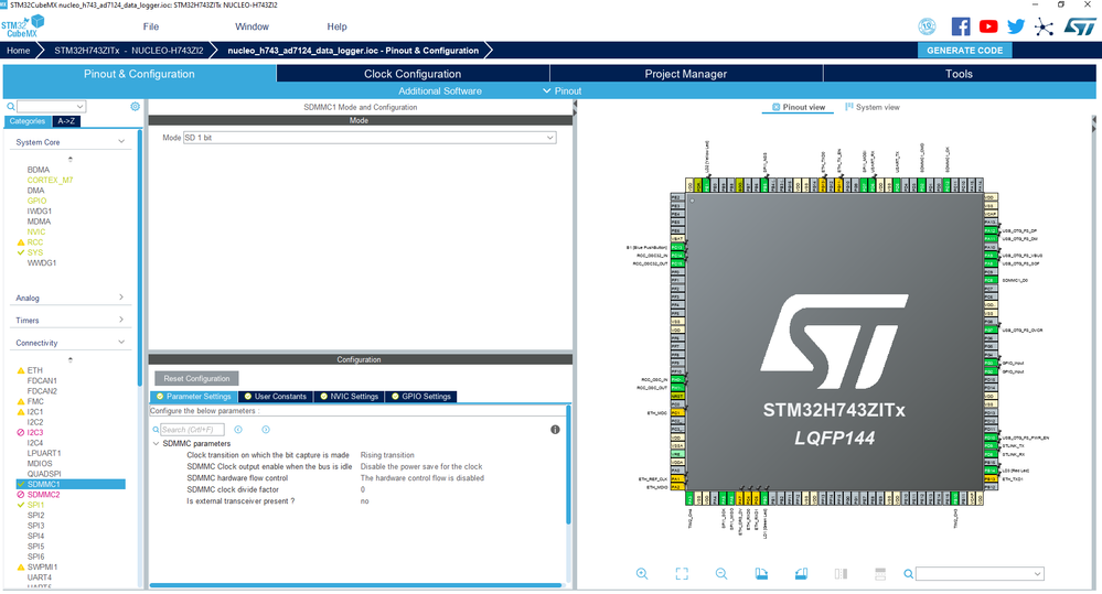

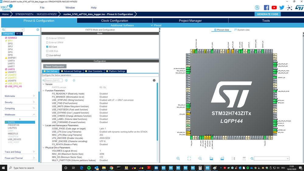

I have configured the H7 SDMMC like the SDIO and also the FATFS the same as the config on STM32F4.
However, the writing on the SD card stops after one time of writing, meaning that data can only be written once on the SD card.
I am attaching the sd card function and my STMCubeMX settings here for your view.
Any help would be greatly appreciated.

2020-02-19 11:43 PM
I will check the clock division. Previously I tried to reduce the core clock, but then the SD stopped working.
Thank you for the comments on my code, I will check those.
>Check IO Cell Compensation is enabled
where can I find this?
Unfortunately, with my skill level and the time pressure I am under, I have no other choice but to use cube.
I will be happy to hear any suggestions.
Thank you again,
Best regards,
Vouria
2020-02-20 1:30 AM
I changed the main clock to a lower clock, and the SD stops working altogether.
when I put the main clock at 338 MHz and sd clock is then set at 48 MHz, then the SD starts working.
It writes the data block on the SD card one time. When attempting to write second time, the f_mount funstion returnrs FR_NOT_READY or FR_DISK_ERROR.
I also used the functions provided in the stm32h7 nucleo, but i get the same results.
Thank you in advance for your help.
Best regards,
Vouria
