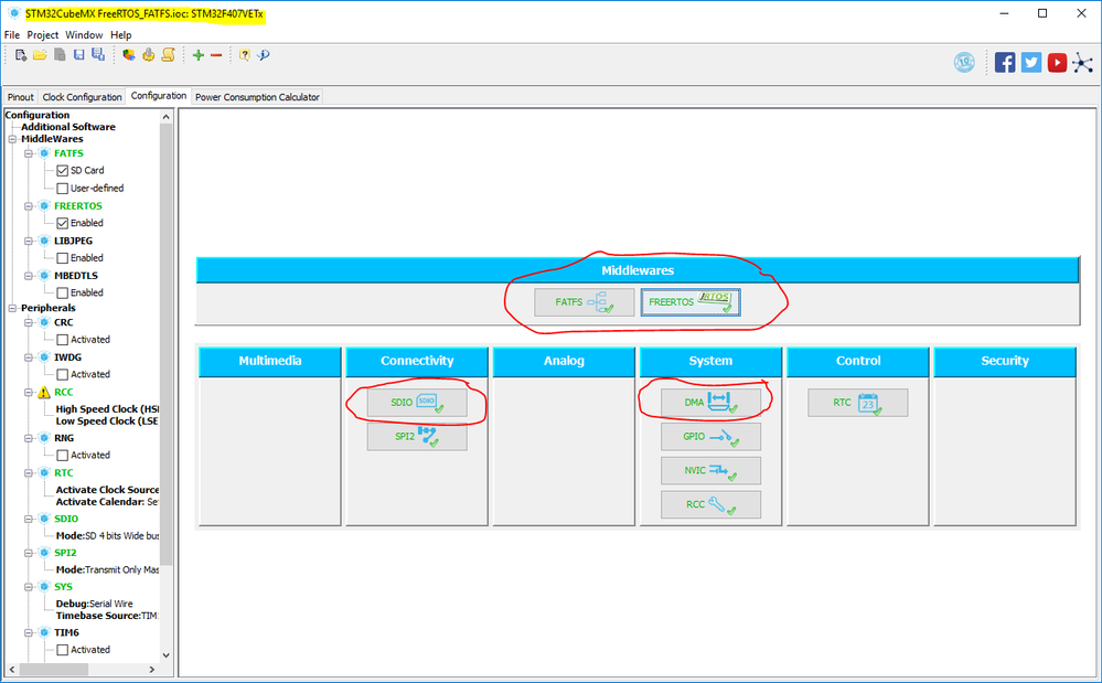

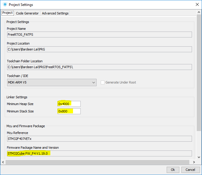

Here is the screen capture of setting STM32CubeMX V4.24

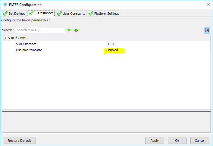

Project Setting:
Make sure FATFS configuration ''Use dma template'' enabled:

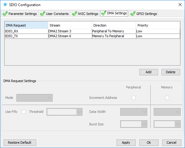

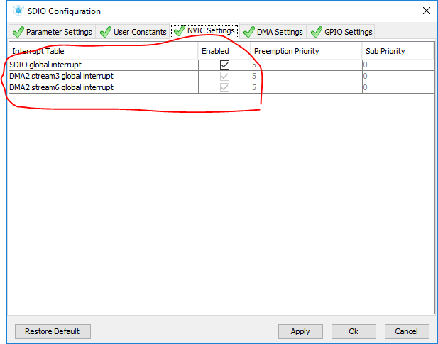

SDIO settings:
Enable NVIC
and DMA settings

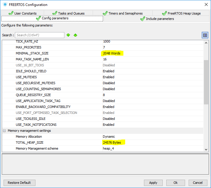

Then, tune the FreeRTOS, stack and heap sizes
