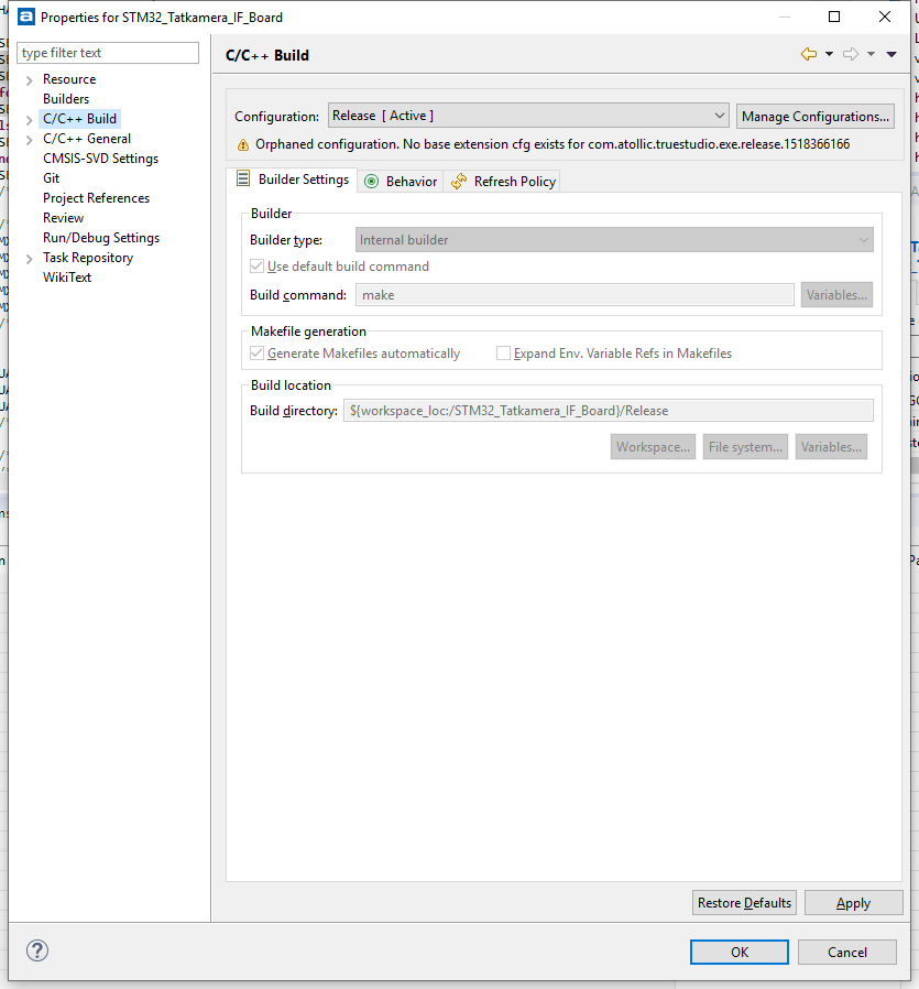

Also, when I go to the build settings and select the release build I see a warning at the top that says 'Orphaned configuration. No base extension cfg exists for com.atollic.truestudio.exe.release.1518366166'. I don't get that when I select the debug build.
So, what does that warning actually mean, and why is the compiler not defined in the release build? (and where is it normally defined?)

Hmm thats worst case end of May... Is there a procedure to manually fix the configuration? I'm very confused by all the different XML Files, can someone explain me which sections I have to copy where to get a working config?

@alister I think you got me wrong. The conversion of the project itself kinda works OK. I'm also not expecting many more iterations with the MX tool and regenerating code as the pinout and initialisation is already working okish.
The question was how to fix the error for the release build in the .project and .cproject files I guess.
I can actually change between debug and release build, the _DEBUG_BUILD define gets evaluated by the syntax highlighting e.g.
#ifdef _DEBUG_BUILD
SEGGER_RTT_printf(0,"Tatkamera IF Board alive (DEBUG Build, GIT Version: %s)\r\n",GIT_HASH);
#else
SEGGER_RTT_printf(0,"Tatkamera IF Board alive (RELEASE Build, GIT Version: %s)\r\n",GIT_HASH);
#endifgreys out the lower part on DEBUG build and greys out the upper part on a RELEASE build. In the debug and release folders I find in both cases a binary file that has the RELEASE printf text compiled in and they are both binary identical. I could live with both builds using the same optimizer settings for now, but I have conditional code that does for instance CRC checking of the flash in the RELEASE build which is not supposed to be compiled into a DEBUG build because it would not give the correct checksum (which I do after linking with some srecord tool foo, so its not in the downloaded ELF file)
That is my main problem right now.

@alister That would imply there was actually a working version of the .project and .cproject files which to my knowledge is never the case. Even a fresh project shows the errormessage in the header of this post about the orphaned config. I have everything in GIT and can try go to the different versions but I doubt I will find something that works.
