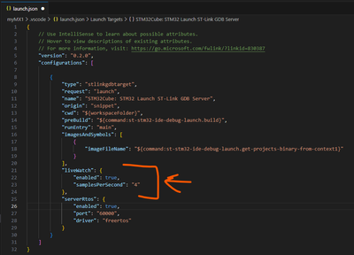

@heloiamquanght why v3.4.11 prerelease while 3.7.0 release is available ?
Let's enable livewatch as part of your launch.json it may help
