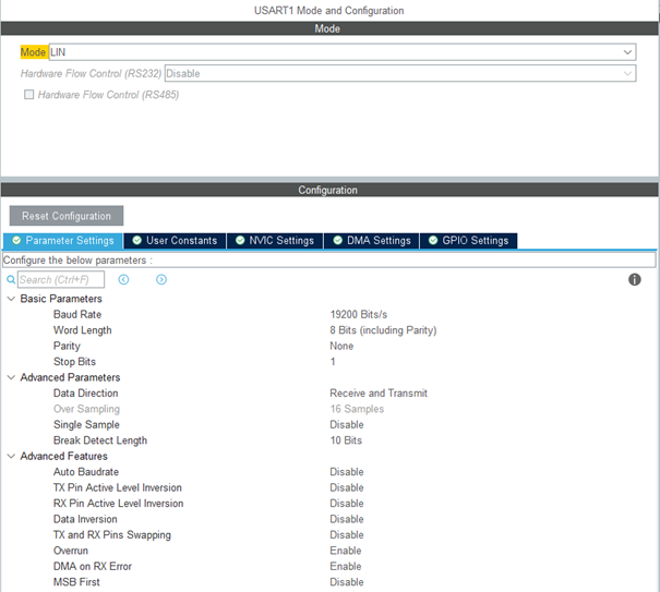

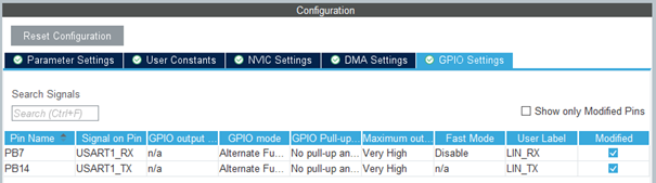

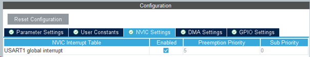

I try to receive data with the USART1 in LIN mode using interrupts. Unfortunately I can't get it to work. This is the configuration of the USART1:
The signal on the LIN bus is composed of the LIN break (HAL_LIN_SendBreak(&huart1);), the sync part (HAL_UART_Transmit_IT(&huart1, 0x55, 1);) and an ID (HAL_UART_Transmit_IT(&huart1, 0x0A, 1);).
The signal looks proper on the oscilloscope. While debugging, I can observe that at least the LIN break is detected by the USART1 (LBDF is set). I expected, that at some point the HAL_UART_RxCpltCallback is called, but that never happens.
What am I doing wrong?
