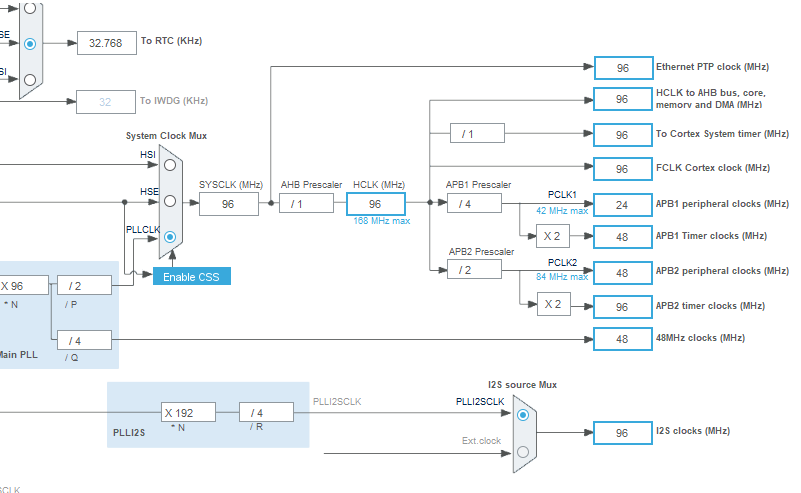

2022-09-18 4:46 AM
Sorry. I didn't realise that I needed to type more details into another box
Here is the reduced clock speed screengrab, i.e at 96hz
but even at 16Mhz I don't see any reduction in current :(

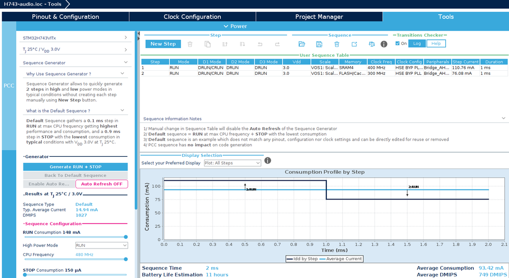

so you reduce clock at an cmos-cpu from 168 to 16 MHz - and see no effect ?
without joking: just test what cube tells you about current of soc , simulation only, but gives you an idea, what will happen in real world;
here test on my H743 audio player: from 400 to 300 MHz down:
