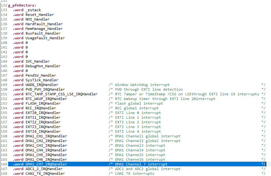

For the beginning I configured three GPIO pins for the LEDs on the board and the LPUART for simple data transfer to terminal on host computer. For the transmission I want to use DMA . After generating the code with CubeMX and implementing some simple blink logic for the LEDs, I added the line HAL_UART_Transmit_DMA(&hlpuart1, buffer, 14); to the main loop. I debugged the code and saw that the code ran into the infinite loop in the DefaultHandler in the startup file startup_stm32l4p5zgtx.s:
After searching for two and a half hour I finally found the problem: the generated names for the interrupt handler in the startup file and the stm32l4xx_it.c are slightly different. See the following sections:

2026-03-20 6:07 AM - edited 2026-03-20 6:08 AM
It appears this bug has been fixed. The code generates correctly on the latest STM32CubeMX version. Update your STM32CubeMX to fix this.

Or, as a workaround, put
#define DMA1_Channel7_IRQHandler DMA1_CH7_IRQHandlerin a USER CODE block at the top of the *_it.c file.
