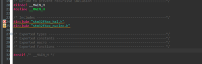

Sorry, I was busy with personal work, I have never used HAL library and don't know how to use it, i have error on the inclusion file I've mentioned below... can you please give me some bare-metal code or with CMSIS?
#include "stm32f4xx_hal.h"
#include "stm32f4

fatal error: stm32f4xx.h: No such file or directory
> fatal error: stm32f4xx_hal.h: No such file or directory
Is it really so hard to troubleshoot this error? Does the file exist? Is it within the include paths?
If you're not using HAL, you shouldn't be including HAL files anywhere.
If you can't troubleshoot this, you may not be successful programming bare metal.
