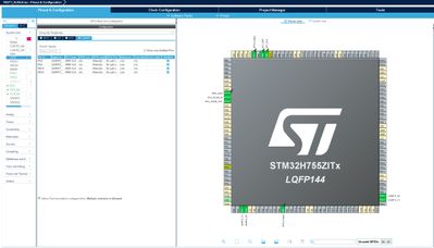

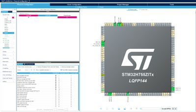

Here's the setup and steps I've followed:
Chip Configuration:
Peripheral Configuration:
2. Debug Configuration:
And, Beside the MCU not able to finding it's target, after restarting the device I receive this,
The interface firmware FAILED to reset/halt the target MCU
I’ve rechecked the configurations multiple times and followed the guidelines for debugging and clock setup. Despite all efforts, the issue persists.

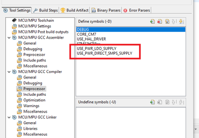

Hello @Daniel_Ismail ,
The issue is due to a limitation in the new CubeMx version described in this thread. Refer to the solution.
Two defines of the power configs are generated by CubeMx for the same project:
You need to remove the define USE_PWR_LDO_SUPPLY from the project preprocessor and need to recover your board from the lock situation. Refer to the thread mentioned previously.

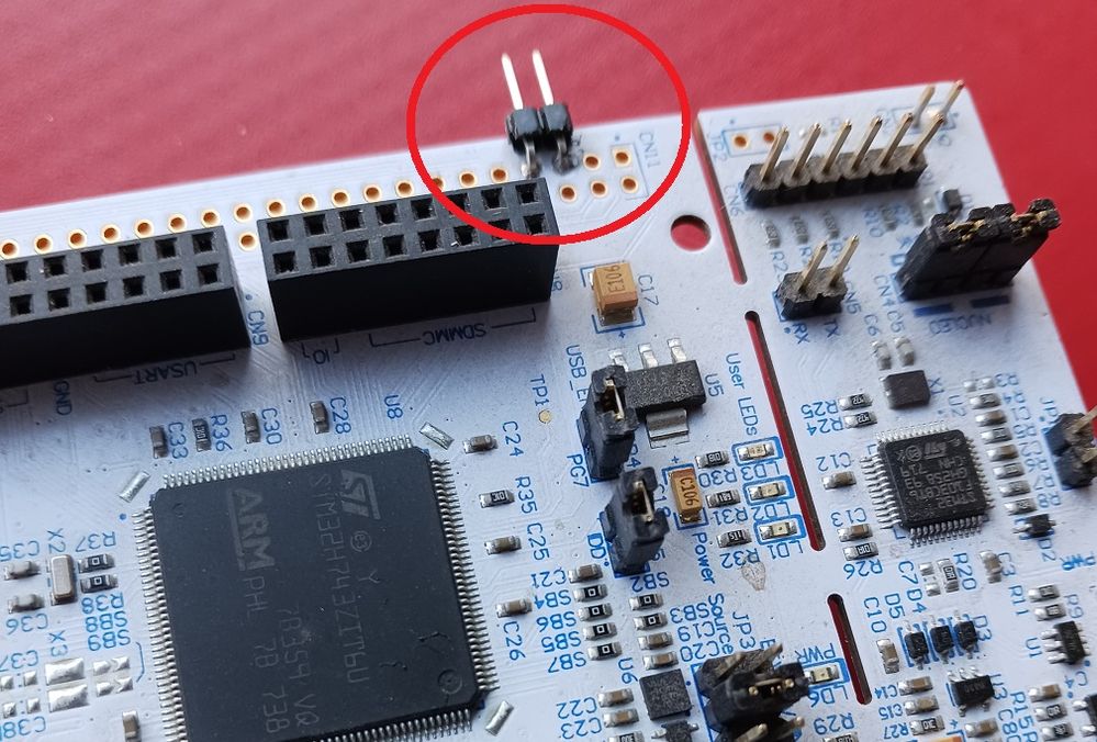

I'd probably solder a right-angle jumper on the BT0/VDD pins of the NUCLEO pin header, and perhaps add a spinning delay in the Reset_Handler() to permit the core to be wrestled by the ST-LINK.

Regarding the suggestion to solder a jumper on BT0/VDD, could you please explain the purpose of this modification? I’d also appreciate more details on how adding a spinning delay in the Reset_Handler() would help and how to implement it effectively.

The BT0 jumper allows for two things, it enters ROM System Loader rather than your code, which provides a safe harbour to erase your broken code running in FLASH. Also if the board is bricked by using LDO rather than SMPS you can power cycle the board completely twice with the jumper on to clear the issue.

2025-01-20 10:05 AM
Thanks a bunch @mƎALLEm !That solution worked perfectly! I had spent days trying to resolve this issue, and this approach finally fixed it as expected. I'll also add the spinning as suggested by @Tesla DeLorean delay to ensure the setup is even more robust. By the way, will the upcoming version include a fix for this issue?
