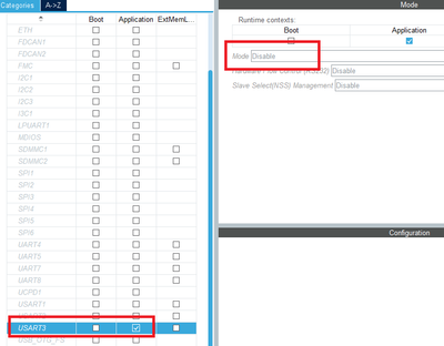

It's showing USART3 is not available.

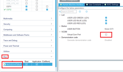

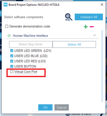

As a workaround, go to the Bsp menu and activate the Virtual Com port then deactivate it , then go back to USART3 under connectivity and you will be able to configure it.

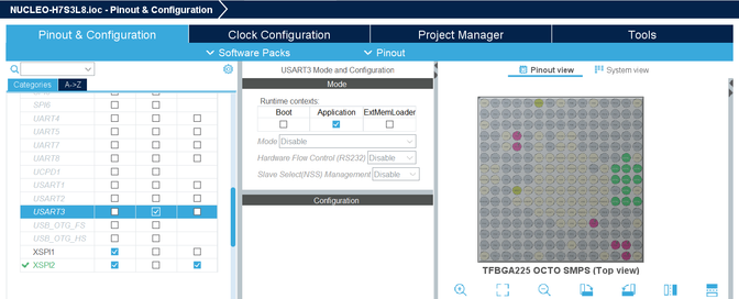

I am not able to do mode configuration.

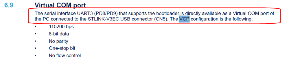

@Shreayas_Acharaya wrote:Could you clarify if I need an external USB-UART converter for UART communication on this board?
What is unclear about this:
It clearly tells you that UART3, using pins PD8 and PD9, is connected to the ST-Link's Virtual COM Port (VCP).
The ST-Link's Virtual COM Port (VCP) is a USB-to-UART bridge; it is built into the Nucleo board precisely so that you do not have to add any external USB-to-UART bridge to communicate via UART3 on pins PD8 and PD9.
Conversely, if you use UART3 (or any other UART) on any other pins, they will not be connected to the ST-Link's Virtual COM Port (VCP) and, therefore, you will have to add an external USB-to-UART bridge.

Thank you,

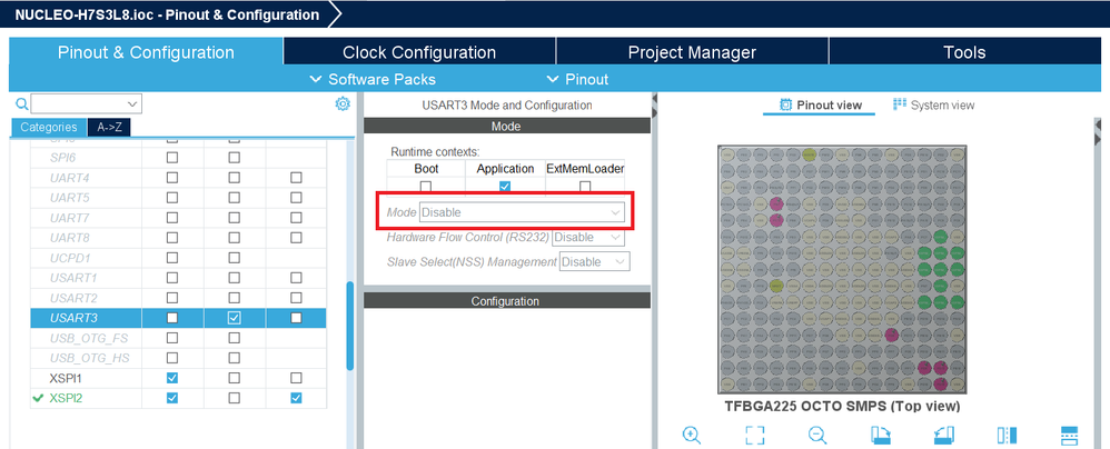

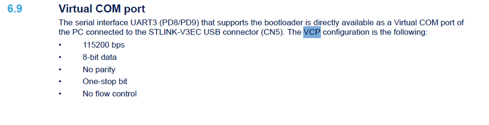

But why am I not able to select the UART mode configuration in the IOC?

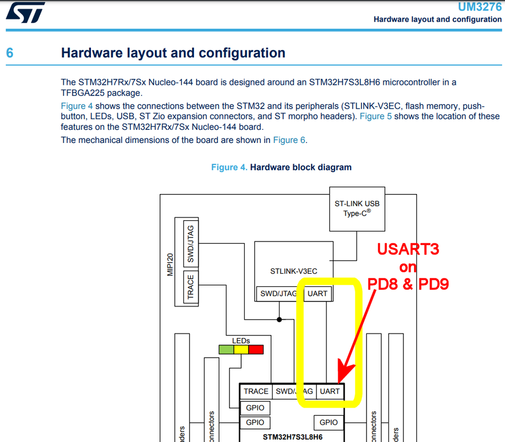

Also, please clarify what this mean:
2024-11-27 1:33 AM
Because simply (I think) you've already enabled USART3 as Virtual Comport at the project creation:
If it is the case, USART3 is ready for usage and you don't need to configure it.
@Andrew Neil already explained it in details in his last comment.
Hope it helps.
2024-11-27 1:34 AM
@Shreayas_Acharaya wrote:Also, please clarify what this mean:
Again, what part(s) of that, exactly, do you find unclear?
What part(s) of the explanation in my previous reply was unclear?

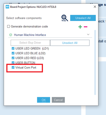

2024-11-27 1:44 AM - edited 2024-11-27 2:02 AM
I tried to create a project starting from a board: NUCLEO-H7S3L8 with virtual comport disabled at the project creation:
But UART3 still disabled:
So I think it's a limitation. Will be escalated internally for analysis.
Internal ticket 197144 for follow-up.
