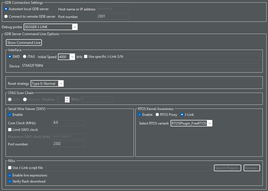

After updating to STM32CubeIDE 2.1.0 I get the following message after starting a debug session. Live expressions do not work.

btw You set the core clock to 8M - really run the core at 8 MHz ?? set the real core clock here.

I have now changed the core speed setting to 216 MHz, but the same issue remains.
Thank you for noticing.
