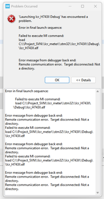

i have project with a'n STM32H743II on a custom board. I use a J-Link Plus to debug and download the program, everthing was working fine. When i updated to version 2.0.0 downloading the program elf file failed. After initialization sequence and downloading the first block the debugger stops, because it can't load the elf file, but the file exists and the path is correct.
Message window:

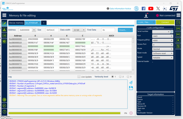

Then i checked the elf file with the CubeProgrammer:

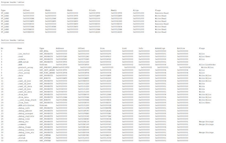

I have the same error message when the program is compiled with older CubeIDE versions. At the moment i can't find any errors in the linker script.
This is the output of the 'elf viewer":
Any clarification or recommendation would be appreciated.
