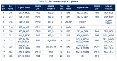

you can use SPI1 on Pins (PA5, PG9, PB5):
Best Regards.
STTwo-32
