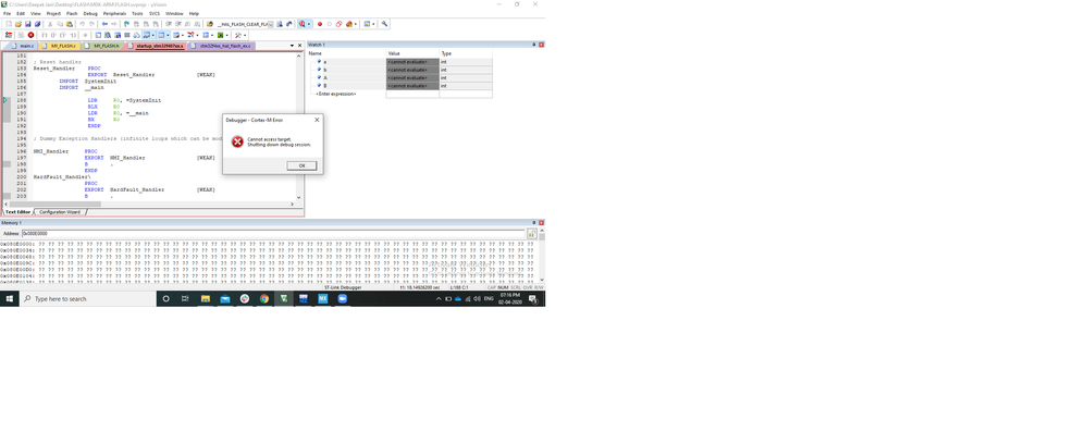

But, while performing step no 3 from above mention steps it causing an error while debugging
"cannot access target shutting down debugging section".
and its come out of debug session

2020-04-02 8:09 AM
OK but that's the problem of debugger not the program on STM32. So either set up your driver so that it won't talk to the target all the time (I don't know how, this is toolchain dependent so resort to manual of your toolchain) or simply run your program without the debugger.
2020-04-02 8:13 AM
There is probably nothing wrong with your code, the issue is with the debugger. However, check that PSIZE is selected properly. Note that FLASH_PSIZE_DOUBLE_WORD needs 8V < Vpp < 9V applied.
Flash erase and write operations block read access to the whole flash memory in the same bank (STM32F407 has only one flash bank, so it is always so), blocking the MCU in the process. Erasing a full 128k sector can take 1 to 2 seconds, the debugger would just timeout. See the documentation of your debugger/IDE, it might offer a way to increase the timeout or reconnect. Setting a breakpoint after the offending instruction, and letting it run instead of single step might help too.
