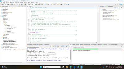

I am writing to report a persistent issue with STM32CubeIDE that is affecting multiple users in our company and blocking our development work.
Issue Description:
When we try to debug any STM32 project, the debugger launch process gets stuck at 51% with the message:
Launching: Initializing debugger services
The issue occurs with different versions of STM32CubeIDE and with multiple target boards.
Steps to Reproduce:
Open STM32CubeIDE and build the project (build succeeds).
Click Debug.
Debugger launch stops at 51% and does not proceed further.

I have attached a screenshot of the IDE progress bar stuck at 51% for reference.
Could you please investigate this issue and suggest a solution or provide a patch/update if this is a known problem?

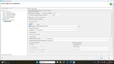

Could you please try debugging with OpenOCD and see if the issue persists? Furthermore, could you provide the st-link_gdbserver_log file (You can generate it by enabling log to file under the Debug configuration.)
KR,
Souhaib
2025-09-17 10:02 PM
I enabled "Log to file," but no file was generated because the debugger never starts (stuck at 51%). I tried with STM32CubeIDE v1.19.0, reinstalled IDE and drivers, created a new workspace, and tested on multiple PCs and boards — the issue persists everywhere. This looks like a possible STM32CubeIDE / ST-LINK toolchain issue, so please escalate it to your engineering team for further investigation.

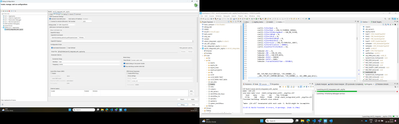

Can we proceed with these steps:
- Run STM32CubeIDE as administrator,
- Reduce optimization level to -O0
- Under Project>Properties>C/C++ Build>Behavior and uncheck the "Enable parallel build"
Otherwise, can you please attach the log file from STM32CubeIDE/Workspace/.metadata
