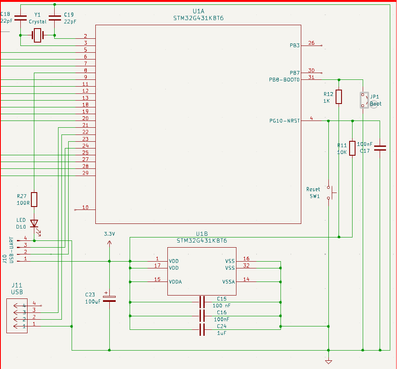

I am experiencing issues when attempting to upload the code to the MCU mentioned above on my board. I am trying to upload the code using the programmer on the STM32F407 Discovery board. It reads the chip, it erases the chip, but it does not upload the code. What could be the reason? The log file and the schematic of the MCU section of my board are below. Thank you for your assistance.

Hello @cereyanmühendisi
Make sure to use the latest release of STM32Cubeprogrammer.
Try disconnecting and reconnecting the device.
Did you have the same issue with both the GUI and CLI?
