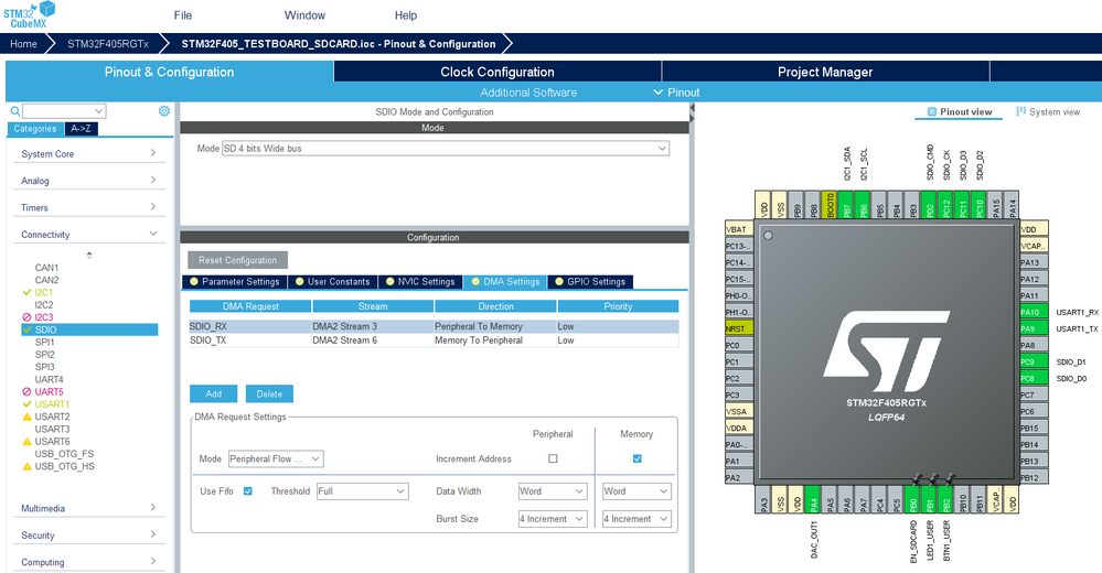

I use a STM32F405 to access a uSDCard.
Software: CubeMX V5.3 and SW4STM32 (Eclipse Neon.3 Release (4.6.3))
The good news, I can communicate with the SDCard (create files, write content and delete files. So far so good, but now the questions:
Q1: How to check if DMA is working?
Where can I see/check that I actually use the DMA which is added in CubeMX in the SDIO section?
Because if I remove the two DMA lines for RX and TX and press the "GENERATE CODE" button again, after re-compiling my unchanged user-code is still working perfectly. I thought there should be a problem now...

Hi AWilk, have you found an answer to your first question? I was thinking the same thing after watching the video you refered to.
Drill into the DISKIO layer, and see what functions it is calling, the DMA ones, or not.
Check if you have interrupt handlers in stm32f4xx_it.c, etc.
Look at a .MAP file to see what functions are linked/bound rather than discarded.
manurp
Associate II
Thank you Clive,
Isn't SDIO automatically linked with DMA when configuring it with STM32CubeMX?
