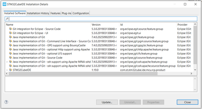

The 'About' tab reports: Eclipse EGit Git integration for Eclipse 5.3.0.201903130848-r org.eclipse.egit
JimEno

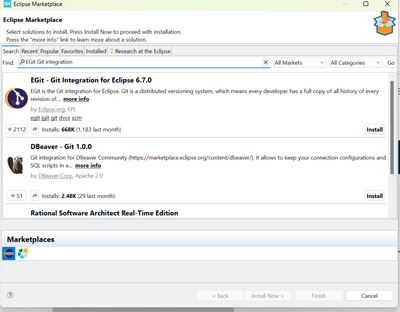

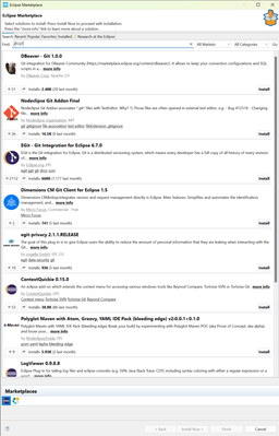

Hello @JimEno
The only EGit option available in the marketplace for STM32CubeIDE 1.19.0 is EGit Git integration for Eclipse 6.7.0. It appears that you are currently using a much older version. Upgrading both STM32CubeIDE to version 1.19.0 and EGit to version 6.7.0 via the Eclipse Marketplace is strongly recommended, as this will provide better compatibility, improved features, and a more reliable Git experience.

I already have STM32CubeIDE 1.19.0 installed. I tried to install EGit Git integration for Eclipse 6.7.0 and it replied, 'cannot complete operation'. It also deleted my older version which left me with no GIT awareness at all. I reinstalled my older EGit 5.3.0 but my existing projects (which I managed to commit somehow) can't access GIT and I've lost all my history. So, thanks for the strong recommendation. Any ideas on how to restore my GIT connection?

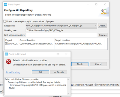

I'm now using a very simple STM example project GPIO_IOToggle for my Nucleo-U5A5ZJ dev board. I fetched it into a clean empty workspace and it builds fine. When I right click on project\Team\Share Project... and fill in the fields, things fail (see below). The repo git repo was created, but the .git file is missing.

@JimEno wrote:The repo git repo was created, but the .git file is missing.
There's your problem. There is no such thing as a .git file. It's not a file it's a folder. Your repo is the root folder that contains the .git folder. It cannot find the .git folder inside the .git folder. So remove .git from the path in the repository field.

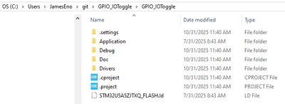

Fine, it's a folder. I can't remove .git from the path, it's grayed out. I retried fresh with all my folders deleted. The 'team\share project' operation seemed to work (see below). So my #2 problem is fixed.
That leaves my #1 problem - can't build after sharing project. I get the following (see below). I find Pavel A's response disturbing - 'Installing arbitrary stuff into CubeIDE can break it and leave you in not-supportable state'. I hardly consider a GIT Archive facility to be 'arbitrary stuff'.
