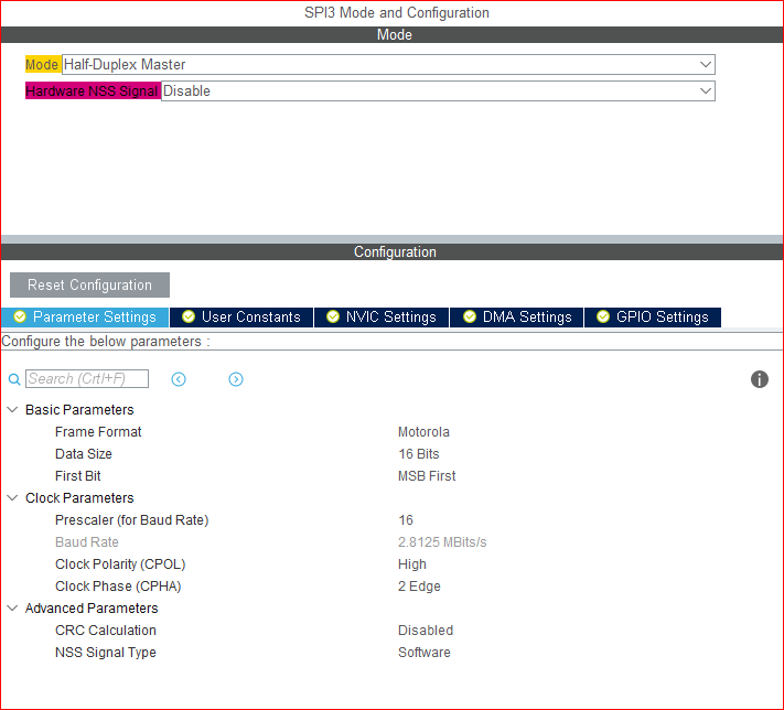

STM32CubeMX is configured as follow

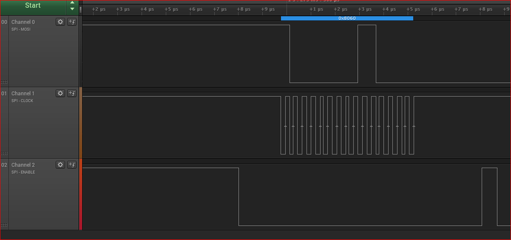

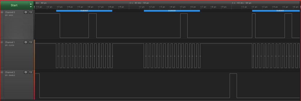

HAL_GPIO_WritePin(CS_GPIOxLib, CS_GPIO_PinLib, GPIO_PIN_SET);A Logic Analyser shows that there are same Errors on the SPI when i try to receive.
But when i changed
hspi3.Init.Direction = SPI_DIRECTION_1LINE;to
hspi3.Init.Direction = SPI_DIRECTION_2LINES;the SPI looks better:

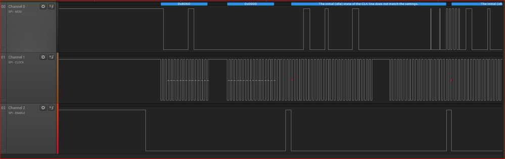

HAL_GPIO_WritePin(CS_GPIOxLib, CS_GPIO_PinLib, GPIO_PIN_SET);the Function HAL_SPI_TransmitReceive goes in TIMEOUT.
When i changed SPI Direction to
hspi3.Init.Direction = SPI_DIRECTION_2LINES;i can see, that STM32 dont spend clocks for receive

If set to master and half-duplex (SPI_CR1.BIDIMODE=1), as soon as turned to Rx (SPI_CR1.BIDIOE=0), SPI starts to automatically output clocks (and shift in data) and does not stop until turned to Tx again. It means, you have to very carefully time the direction turns. Cube/HAL has probably no provision for this - it's one of the many specialty uses of STM32 hardware, and Cube/HAL covers inevitably only the most common modes of use.
