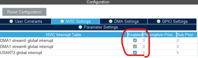

※This code will not work unless the DMA and UART interrupts are enabled.

2022-02-24 4:57 PM
I had a similar issue, for me it was the interrupt priority settings on the NVIC tab under Pinout and Configuration in CubeMX. Lower numbers are higher priority. I would also check the clocks for the USARTS to make sure they are adequate, check the baud rates etc are the same and the GPIO speeds on the USARTS are adequate.
2022-02-24 10:34 PM
