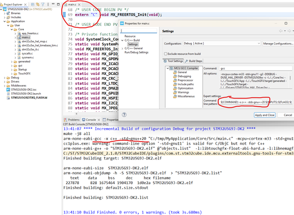

2026-04-08 5:52 AM - edited 2026-04-08 6:03 AM
try to use "-x c++" with .c files you want to compile as c++.
