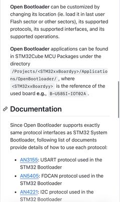

My recommendation to explore our Open bootloader example that should be supported by the STM32CubeProgrammer here :
https://github.com/STMicroelectronics/stm32-mw-openbl?tab=readme-ov-file

2026-04-01 6:29 AM
Hi STOne-32
I imported the OpenBootloader softwarein my custom bootloader project, and everything works fine.
I can download a Application Program larger than 1 MByte using both the DfuSe Demo program and the STM32CubeProgrammer.
However, I noticed a significant slowness compared to a download performed using the Bootloader Internal to the device's System Memory.
I also noticed the same slowness when using your STM32U5G9J-DK1 demo board with your bootloader application included in the STM32Cube_FW_U5_V1.7.0 package.
Do you have any suggestions for improving this?
Thanks in advanced.
