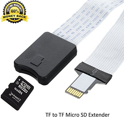

To facilitate the connection of the SD-Card I used a uSD extension so I can not use the "card dettect" pin.

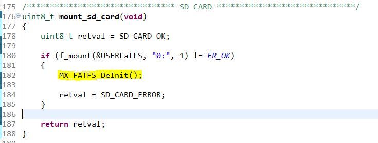

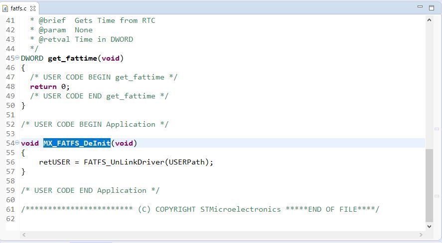

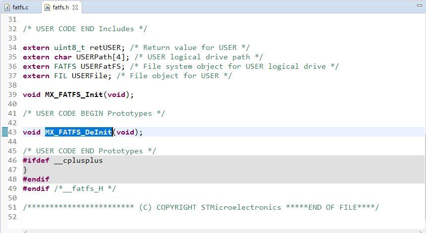

After analyse the problem, I discovered the following solution.
Edit the fatfs.c file with the following
And, of course, declare the function in fatfs.h
My code to mount the SD card looks something like this:
Problem solved.

I do not have access to the card detect pin. The extension is always placed in the socket.

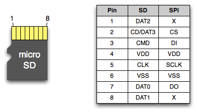

You'll need to reparse what I said. The CARD has a pin typically usable for this purpose, not just the SOCKET one you're focusing on.
CD/CMD3
