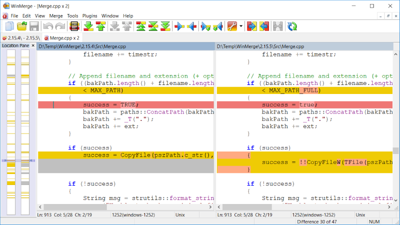

to find what the difference between them
There are specific programs for comparison

I was dealing with this just the other day. I had to use CubeMX to switch processors, pull the ioc into CubeIDE to actually use it, but now I have to make sure that all of the options are set properly.
Open one ioc, switch to the other and the first one closes. BAH. The principle of least surprise led me to expect that I could just switch between the two ioc files in the Device Configuration Tool tabs but - sigh - no.
I ended up using Beyond Compare (excellent tool) to compare the contents of the ioc files which told me where to look in CubeIDE for stuff to change.
