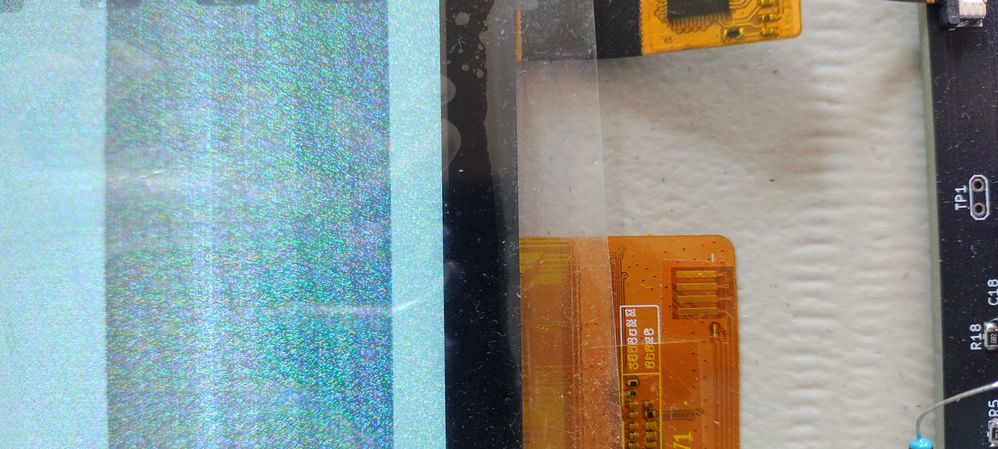

2025-02-17 8:00 AM
Hello.
I have done a debug.
When the first MX_TouchGFX_Process(); is called all is corrupted.
MX_GPIO_Init();
MX_DMA_Init();
MX_QUADSPI_Init();
MX_FMC_Init();
MX_CRC_Init();
MX_LTDC_Init();
MX_DMA2D_Init();
MX_TIM2_Init();
MX_SDMMC1_SD_Init();
MX_FATFS_Init();
MX_I2S1_Init();
MX_USART1_UART_Init();
MX_I2C1_Init();
MX_USB_HOST_Init();
MX_TouchGFX_Init();
/* USER CODE BEGIN 2 */
/* USER CODE END 2 */
/* Infinite loop */
/* USER CODE BEGIN WHILE */
while (1)
/* USER CODE END WHILE */
MX_USB_HOST_Process();
/* USER CODE BEGIN 3 */
}I am not using FreeRTOS.
This image shows the display.
