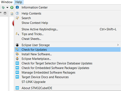

2023-08-21 7:30 AM
I just have to click on this button ?
2023-08-21 8:20 AM
Yes.

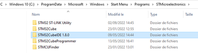

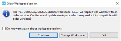

2023-08-22 12:12 AM - edited 2023-08-22 1:46 AM
After installing the new version I got this message below :
I answer why it still keeps the old version and not the 1.13.1 version
I'll try if I don't have an error from CUBEMX.
I can launch STM32CUBEIDE but it closes automatically.

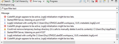

And I have this message below :
What does that mean 'Log4j initialization ....too late ?' I think something is wrong between STM32CUBEIDE and STM32CUBEMX.
Do you have the right method to update the software ? Thank you for your helps

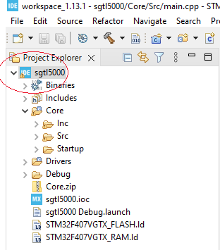

But now I can open STM32CubeIDE and the file .ioc with STM32CubeMX but have an exclamation mark like this picture below :
Do you know why ? And how to remove this point (probably a warning)
2023-08-22 7:29 AM
Try to refresh the project (F5) then clean and rebuild. Will it build successfully?
2023-08-22 1:21 PM
I don't try this method but, when I show the warning and I hit Ctrl+1, the warning has disappeared.
Thank you every body for yours helps.
