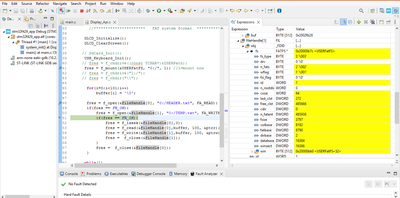

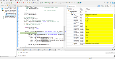

When I open the fileHandle[0] it open successfully and fres is set as FR_OK. when fileHandle[1] is opened it reset the parameters of the fileHandle[0] (specifically obj.id and obj.fs.id is mismatched) and return FR_OK as response. When I try to read from the file1 using fileHandle[0] , it sends the FR_INVALID_OBJECT Errror which is due to filehandle[0] parameter corruption. The debugging window screenshot is attached.
Why the fileHandle[0] gets corrupted when anotherfile is opened. Please suggest the solution of this problem. I am stuck here.

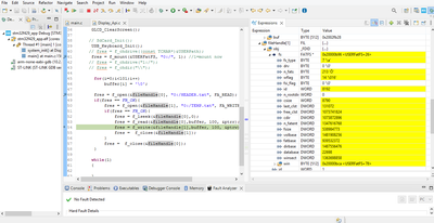

With this I am able to open the two file simultaneously as in the below code but when read operation is performed in the file 1 then handle of the 2nd file gets corrupted.
I have tried all the combinations but not able to identify the solution why the file handle is being corrupted?

1: fileHandle[0] after open:
2: fileHandle[1] after open:
3: fileHandle[1] after reading from fileHandle[0]:
Please help to find out the issue. I am stuck at this point.
