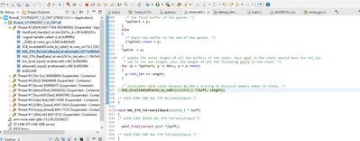

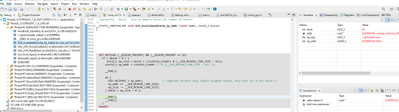

2025-05-05 6:14 AM - edited 2025-05-05 7:25 AM

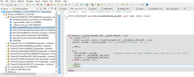

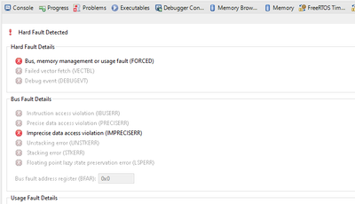

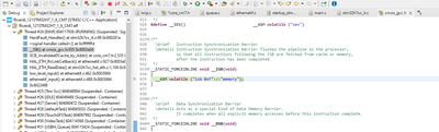

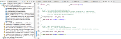

Today it goes to HardFault from __ISB or __DSB:
Stack for __DSB
And stack for __ISB

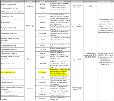

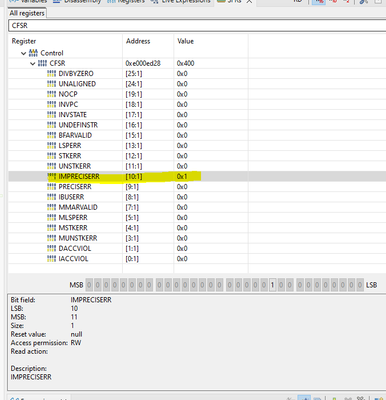

If could be helpful the CFRS is IMPRECISERR

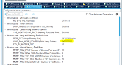

I observe that memp_memory_RX_POOL_base is at 0x30000400 and its size is 18,38KB, so memp_memory_RX_POOL_base spans in 0x30000400..30004BCC.
Starting from this I set LWIP_RAM_HEAP_POINTER to 0x30005000 because I suspect that memp_memory_RX_POOL_base overlaps LWIP_RAM_HEAP_POINTER.

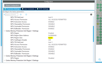

Then I go to MPU and increase MPU Region 1 Size from 16K to 64K because it started from 0x30000400 and its size is 0x30005000-0x30000400+14KB

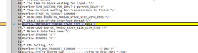

Subsequently I increase INTERFACE_THREAD_STACK_SIZE from 350 to 1KB ..
And I increase that stack of Server thread from 1KB to 10KB (even if I want to undersand how to reduce it to a minimum necessary size)
