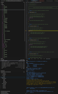

3. Open the entire project with VSCode. The project by default uses the PICOLIBC in the file starm-clang.cmake. The project as is compiles successfully. flash onto the board and click Continue. The code will instantly go in HardFault_Handler().
Here is a printscreen:
 Can anyone try to reproduce this, just to make sure it is not something only on my side? Thank you!

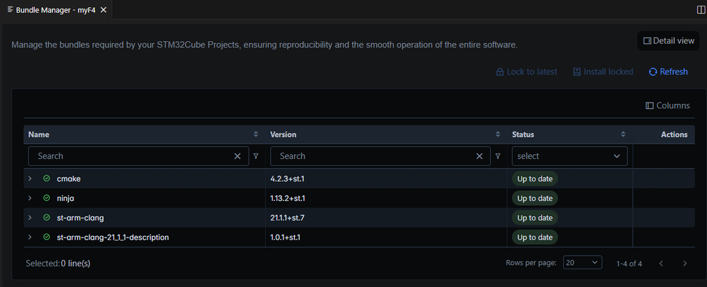

@ANeam.1
Please be aware STM32Cube bundle st-arm-clang@21.1.1+st.7 delivered today is fixing issue.
Please have a try updating and locking proper version to your project:
Additional information about the fix is detailed here in @FluxPower42 's thread.
