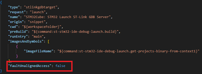

2025-07-29 12:30 AM
Hi PierreB,
There is a view that shows the type of error occurring:
And I know that the "unaligned access" error is enabled by default in the ST debug configuration.
You can check the attributes starting with "fault", ex: faultUnalignedAccess

2025-07-29 2:10 AM
On my side, I simply disable it by setting the attribute to false in my debug configuration.
