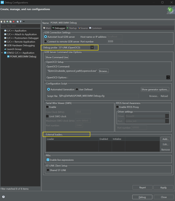

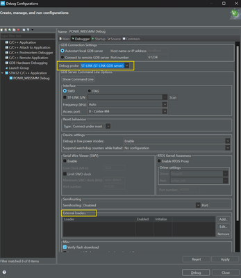

To add the external loader, you need to select ST-Link (ST-LINK GDB server) or ST-LINK (OpenOCD) as Debug probe.
Thanks.
Mahmoud

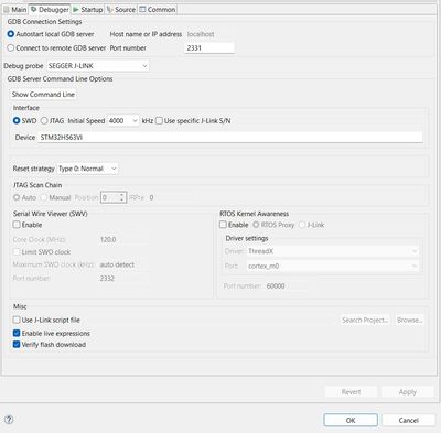

Is this not available with a Segger J-Link? (when I used CubeProgrammer I select JLink/Flasher as the probe).
Is it possible use the J-Link to program the H563 and external SPI flash via CubeProgrammer CLI?

Sorted now using CubeProgrammer CLI.
2025-12-02 1:46 AM
J-link has own solution for external loader read J-LINK manuals,
