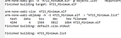

I was able to open your IOC file, generate code, and build the project without issue.
Perhaps you have something special going on on your computer. Perhaps this is a linux case sensitivity issue, or folder permissions issue, or an overactive virus scanner. Do the files exist on the disk? Does "generate code" complete and pop up the Open Folder / Open Project popup?
