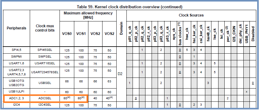

Hi @Mikhail Z ,
Actually, the maximum ADC frequency depends from the voltage scale value, and according to RM, the Max value cannot exceed the 80Mhz.
In fact, when the Power regulator voltage scale is set to 0 or 1, the Max ADC freq equal to 80MHz, in case when the Power regulator voltage scale is set to 2 or 3, its equal to 40 MHz (for more details, please refer to the Table 59 in the RM).

Hi @Mikhail Z ,

2021-03-11 12:56 AM
@Khouloud ZEMMELI , thank you for clarification. I just don't understand how it is possible to make the 50MHz ADC clock since for STM32H743 ver. V the minimum clock divider is 2 (so for 50MHz at least 100MHz kernel clock is needed).
