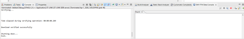

2026-04-01 3:27 PM
When I upload the code it works as excepted on the SMT32F407-DISC1 board, but timestamps can not show in the SWV interface

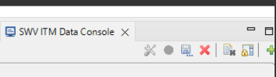

2026-04-06 2:47 AM
Hello @KING2, and welcome to ST Community!
To enable timestamps during debugging, click on the wrench icon in the debug toolbar and check the option Enable Timestamps.

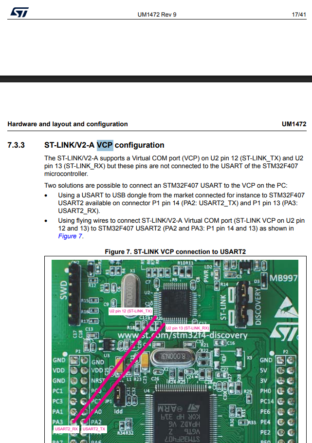

2026-04-07 2:53 AM
@KING2 wrote:I do not have cables to use COM
@KING2 wrote:SMT32F407-DISC1
The User Manual tells you how to add the VCP (Virtual COM Port) connection:
via: https://www.st.com/en/evaluation-tools/stm32f4discovery.html#documentation
Alternatively, just add an external USB-to-UART adaptor
