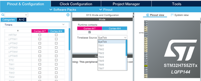

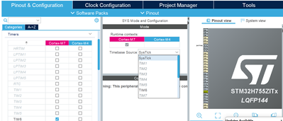

Associate II
I am not able to set the HAL timer source from SysTick to TIM configuration in STM32CubeIDE.
I checked the configuration, but the option is not getting updated properly. Could you please help me with the correct way to configure the timer-based time source?

I have attached two images:
  1. Before enabling the timer
  2. After enabling the timer
Before enabling the timer, only SysTick is available in the Time Base Source option, which indicates that no timer is enabled.
My question was regarding the HAL time source configuration. To set the HAL time source to any timer, the corresponding timer must be enabled first. Only after enabling the timer configuration will it be available for selection as the time source.

So the question here: are the below screen shots you shared are taken from the standelone CubeMx tool or from an old version of CubeIDE?
@Ranjitha wrote:
IMAGE:1 Screenshot 2026-05-27 105143.png
IMAGE 2: Screenshot 2026-05-27 104333.png
