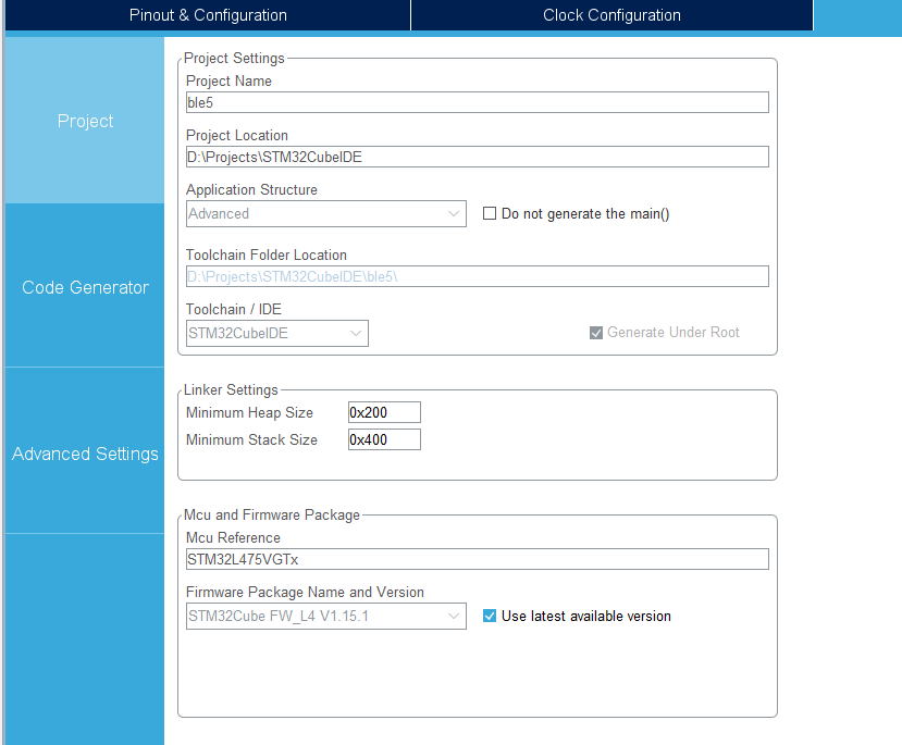

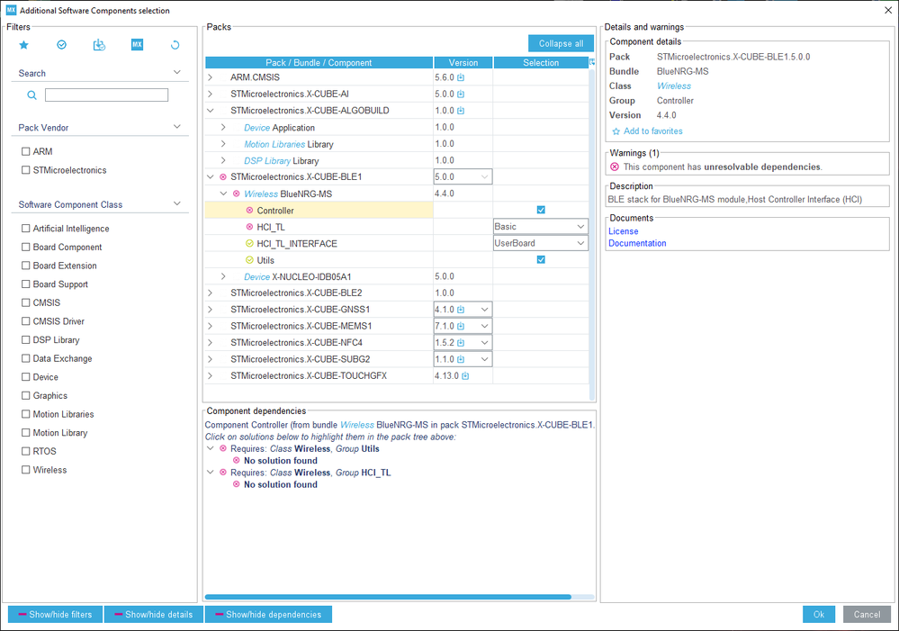

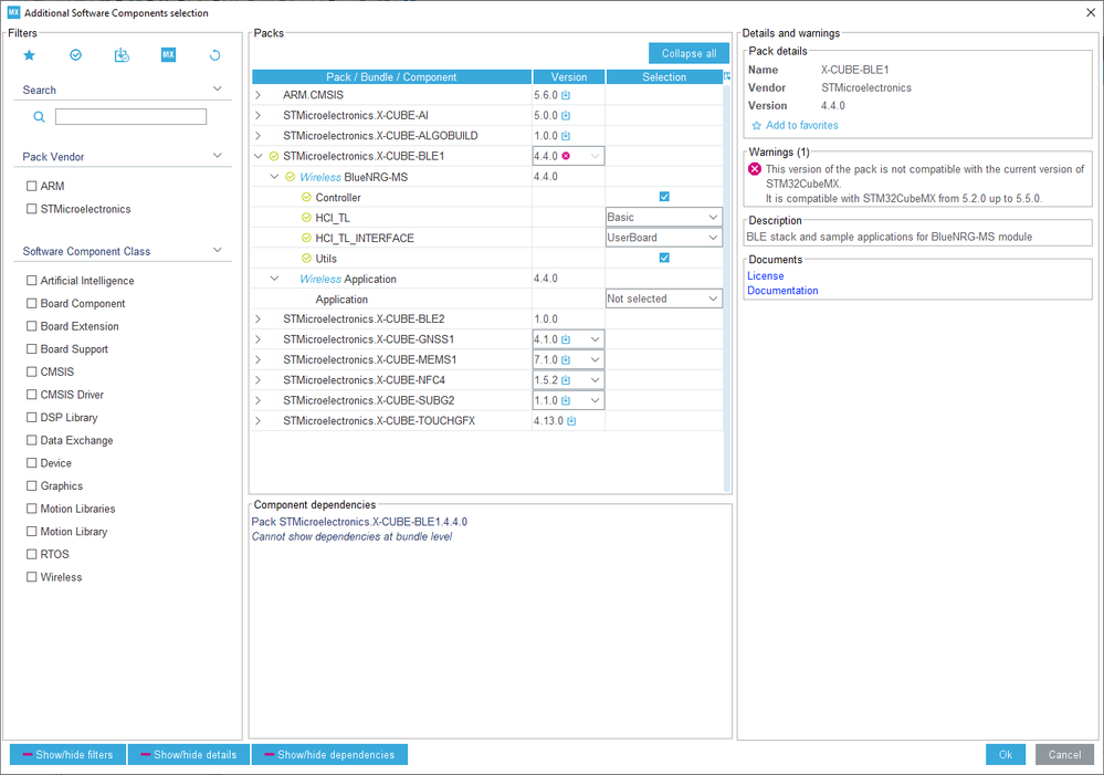

I created the project from scratch as follows:
If i select X-CUBE-BL1 components, for version 5.0.0, it displays errors for Controller and HCI_TL saying, the components have unresolved dependencies, and no solution found. See attached picture.
If I select 4.4.0, it says this version is not compatible with the current version of cube mx. see attached pic.
No other version option is listed.
I configure the pins as in the first post.
When I want to build, I get the follwoing with both configs:
If I clear the pins as you suggested, it is all the same.
If I use your attached ioc, it is all the same.
I cannot change the app structure at code generation, it is disabled:
