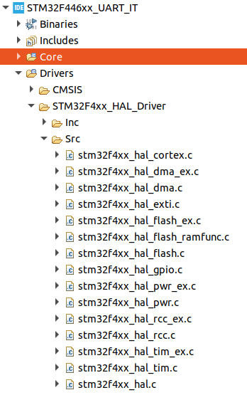

I have generated my code using CubeMx tool in STM32CubeIDE. I find the stm32f4xx_hal_uart.c missing from the project. But when I generated the code by enabling the uart as asynchronous mode the second time, the uart appears in the driver folder. Why uart is missing?

It has copied the necessary drivers for the configured peripherals only. There must be some checkbox to change this behaviour in CubeMX.
