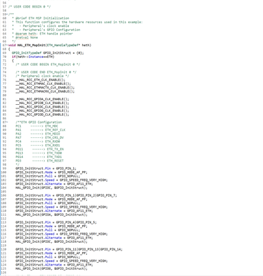

2025-09-29 6:09 AM - edited 2025-09-30 5:04 AM
Hello @crazy88
Following your description of reproduction steps:
By checking stm32f4xx_hal_msp.c , the following code will be generated successfully using CubeMX 6.15.0 and IDE 1.19.0
void HAL_ETH_MspInit(ETH_HandleTypeDef* heth)
if(heth->Instance==ETH)
/* USER CODE BEGIN ETH_MspInit 0 */
/* USER CODE END ETH_MspInit 0 */
/* Peripheral clock enable */
__HAL_RCC_ETH_CLK_ENABLE();
__HAL_RCC_GPIOC_CLK_ENABLE();
__HAL_RCC_GPIOA_CLK_ENABLE();
__HAL_RCC_GPIOB_CLK_ENABLE();
/**ETH GPIO Configuration
PC1 ------> ETH_MDC
PA1 ------> ETH_REF_CLK
PA2 ------> ETH_MDIO
PA7 ------> ETH_CRS_DV
PC4 ------> ETH_RXD0
PC5 ------> ETH_RXD1
PB11 ------> ETH_TX_EN
PB12 ------> ETH_TXD0
PB13 ------> ETH_TXD1
GPIO_InitStruct.Pin = GPIO_PIN_1|GPIO_PIN_4|GPIO_PIN_5;
GPIO_InitStruct.Speed = GPIO_SPEED_FREQ_VERY_HIGH;
GPIO_InitStruct.Alternate = GPIO_AF11_ETH;
HAL_GPIO_Init(GPIOC, &GPIO_InitStruct);
GPIO_InitStruct.Pin = GPIO_PIN_1|GPIO_PIN_2|GPIO_PIN_7;
GPIO_InitStruct.Pin = GPIO_PIN_11|GPIO_PIN_12|GPIO_PIN_13;
/* USER CODE BEGIN ETH_MspInit 1 */
/* USER CODE END ETH_MspInit 1 */
But since you have mentioned that you are using **PHY**: YT8512C , not using LAN8742 or DP83848 ( in those cases the GPIO code will be placed in ethernetif.c).

2025-10-01 5:04 AM
Dear @Ghofrane,
Thank you for your prompt response and verification! The earlier issues with pin multiplexing initialization and the uninitialized PD3 REST pin only occurred during the first code generation and were resolved after reconfiguration.
The current main problem is that the ICMP test keeps failing. I’m using a third-party development board, and the hardware has been proven functional through official examples. However, after using STM32CubeIDE with FreeRTOS + LWIP, the ICMP test has never passed, and even the ETH interrupt has not been triggered. I’ve been troubleshooting for nearly half a month and am unable to resolve it. Could you please help me identify the issue?

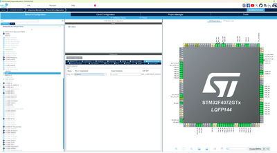

2025-10-13 7:13 AM
Hello @crazy88
I have reviewed your IOC file and noticed that you enabled both ETH and LWIP without selecting a PHY driver
In this scenario, since the configuration is incomplete (specifically, the Platform Settings under LWIP), CubeMX will not generate the necessary GPIO initialization code for Ethernet, which is the expected behavior.
As a workaround, you copied the initialization code that CubeMX generated when only ETH was enabled. I assume that, in this configuration, the Ethernet interrupt priority was set to 5 then you placed this code in the user section 0 of stm32f4xx_hal_msp.c.
Is that how you proceeded?

2025-10-22 9:42 PM
i'am sorry to reply so late,i' ve been busy these days. and,yes,that's exactly what i did.I put these code in the user section of stm32f4xx_hal_msp.c. I want to know which function of whinch file for the generator generate HAL_NVIC_SetPriority ,thx;
