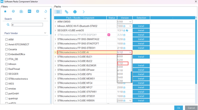

Environment:
STM32CubeIDE 2.0.0 (with embedded CubeMX)
X-CUBE-AI 5.1.2
Create a project in standalone STM32CubeMX.
Clear pinouts, configure peripherals, and enable X-CUBE-AI.
Generate the code → Build succeeds.
Close CubeMX and close the entire project.
Open STM32CubeIDE 2.0.0 → open the .ioc file.
When opening the IOC inside CubeIDE, the X-CUBE-AI package becomes deinitialized, and:
X-CUBE-AI settings are lost
The 5.1.2 version selection resets every time
Code regeneration requires reconfiguring AI settings again.

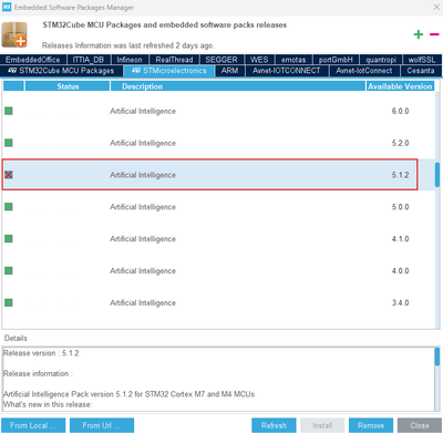

2025-12-15 12:29 AM
Hello @yaswanth_cdac ,
As Workaround, I recommend that you remove X-CUBE-AI 5.1.2 from the STM32Microelectronics package list reinstall it again and click on Refresh.
Thanks.
Mahmoud
2025-12-15 1:33 AM
ok,
Thank you, for solving the error in 5.1.2 package of x-cube-ai.
