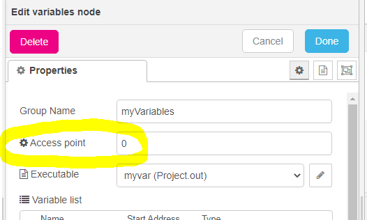

Thanks' for your feedback, those 2 commands are part of the tool since a while, Could be the default access point value that is not a supported AP value for those 2 boards.
Access point value can be accessed when editing the variables node:
