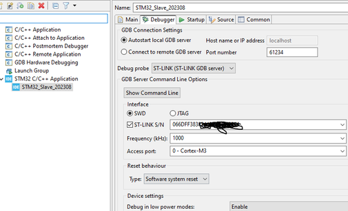

  • STM32CubeIDE configured as picture.  Freq at 1000K to match slow speed set in the Monitor
  • Also Debug Config has ST-Link Shared

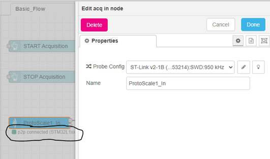

STMCubeMonitor has the probe set up like this:
... it's connected and everything.

I finally open my eyes and see your configuration is p2p whilst it should be tcp. You also need to configure STM32CubeMonitor in shared mode:
 https://wiki.st.com/stm32mcu/wiki/STM32CubeMonitor:How_to_configure_shared_mode
