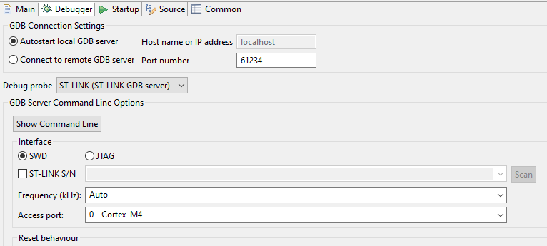

Settings in IDE

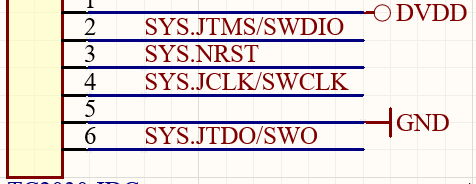

These are the lines that are connected between STLINK and board

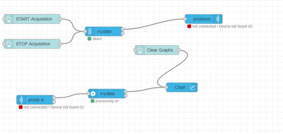

This is my setup in CubeMonitor

I have successfully resolved the "device not found" issue. It turns out that there were two executable configuration nodes in my design, but one of them was not visible. After discovering the hidden node and deleting it, everything started working as expected.

Hi
In order to debug simultaneously, you need to change connection type to "tcp": please read wiki.
