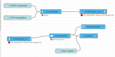

I had to run the script in debug mode for this to take affect and, interestingly, it did not terminate, nor did it run.  It paused somewhere and gave me this error in the CubeMonitor
     [not connected ! Device not opened (5)]
Probe_in and Probe_out are the same and defined like this:
I can hit the 'Blink the LED' and that works.

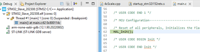

Back to the IDE, when I hit the debug button I get these results:
STMicroelectronics ST-LINK GDB server. Version 7.4.0
Copyright (c) 2023, STMicroelectronics. All rights reserved.
Starting server with the following options:
Persistent Mode : Disabled
Logging Level : 1
Listen Port Number : 61234
Status Refresh Delay : 15s
Verbose Mode : Disabled
SWD Debug : Enabled
InitWhile : Enabled
Waiting for debugger connection...
Debugger connected
Debugger connected
STM32CubeProgrammer v2.14.0
Log output file: C:\Users\xxxx\AppData\Local\Temp\STM32CubeProgrammer_a07164.log
ST-LINK SN : 066DFF383834434257153214
ST-LINK FW : V2J43M28
Board : NUCLEO-L152RE
Voltage : 3.26V
SWD freq : 4000 KHz
Connect mode: Under Reset
Reset mode : Hardware reset
Device ID : 0x437
Revision ID : Rev Z
Device name : STM32L15xxE/STM32L162xE
Flash size : 512 KBytes
Device type : MCU
Device CPU : Cortex-M3
BL Version : 0x40
Debug in Low Power mode enabled
Memory Programming ...
Opening and parsing file: ST-LINK_GDB_server_a07164.srec
File : ST-LINK_GDB_server_a07164.srec
Address : 0x08000000
Erasing memory corresponding to segment 0:
Erasing internal memory sectors [0 649]
Download in Progress:
File download complete
Time elapsed during download operation: 00:00:07.771
Verifying ...
Download verified successfully
I note that the IDE brings up the main.c file with the HAL_init() highlighted.

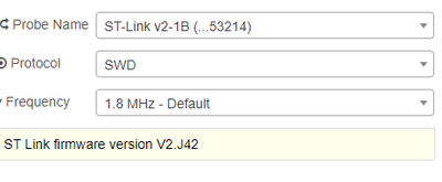

I note that the SWD freq mentioned by my IDE does not match any of the options available in the Monitor.  Is that my issue?  If so, how do I change it?
{{Update: I set the SWD Freq to 950 kHz and the CubeMonitor Probe to 950kHz.  Nothing changed.  The device is still not registering as 'opened'}}

Resolved!  I had a conflict on pins PA13 and PA14 which are used by SWD

The method for changing the SWD Frequency is
In the CubeIDE on the action ribbon the Debug is a pull-down menu.
  • pulled it down and selected Debug Config
  • selected the Debugger tab
  • changed the Frequency to 1000
  • Changed the Debug in low power modes to Enabled
  • ST-LINK SN : 066Dblahblahblah
    Voltage : 3.27V
    SWD freq : 950 KHz
In CubeMON
  • doubled clicked on the probe (acq in)
  • hit the light bulb and see the led light flash (taking a win wherever I can find one)
  • hit the pencil next to Probe Config
  • selected the 950 kHz
Now they match.  Still no joy
