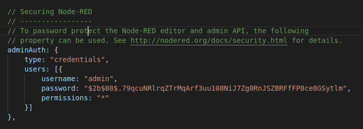

Hello @_acv_atr
I tried using user and password at settings.js for both STM32CubeMonitor-1.3.0 and newly published 1.4.0 and didn't face any issue such as the one you mentioned (see attached settings.js). Can you detail your environment and the modification you made.
// Securing Node-RED
// To password protect the Node-RED editor and admin API, the following
// property can be used. See http://nodered.org/docs/security.html for details.
adminAuth: {
type: "credentials",
users: [{
username: "admin",
password: "$2a$08$zZWtXTja0fB1pzD4sHCMyOCMYz2Z6dNbM6tl8sJogENOMcxWV9DN.",
permissions: "*"
default: {
permissions: "read"

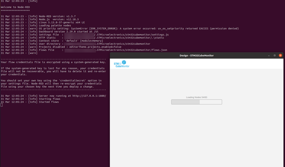

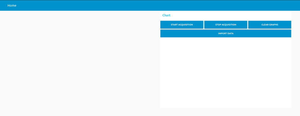

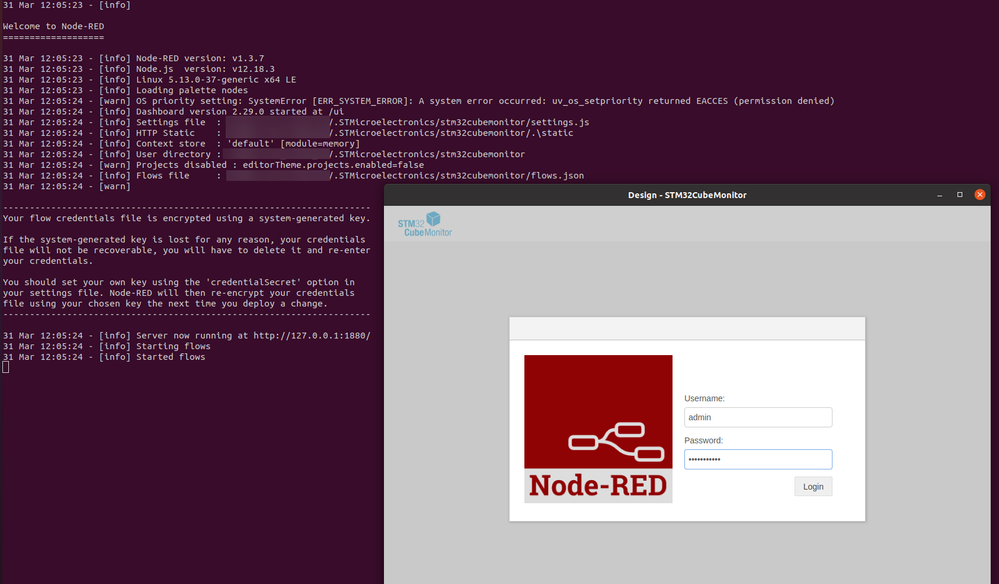

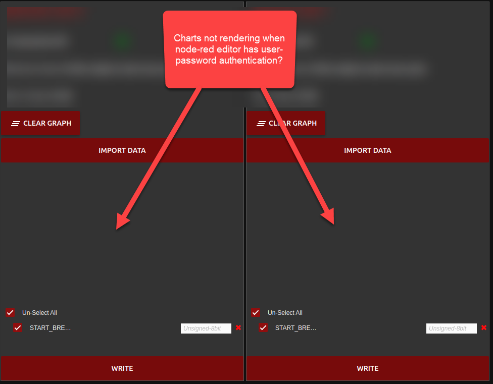

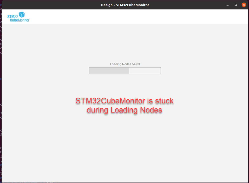

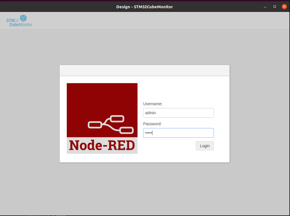

Hello @Richard.Chvr
Going in more detail:
OP: Ubuntu 20.04 desktop
CubeMonitor: v1.3.0
user: admin
password: admin_1234#
FLow: default from ST, after fresh installation
Editor asking for password as expected:
Editor stuck after enter correct password:
Node-RED UI not working properly after correct login
Please consider flow and settings on attachment.
If you need further details, let me know.
Thank you
