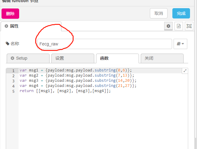

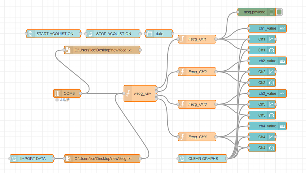

My node design is shown in Figure 1. The serial port input is connected to a function Fecg_raw(), as shown in the second picture.

Hello
When the throughput of data is too high, there is some delay in the display. Some data can be buffered by the serial port driver, by node-RED backend and by frontend. When many data are sent from backend, there can be some delay in the display.

> When the throughput of data is too high ... node-RED backend
https://en.wikipedia.org/wiki/Node-RED
So it's basically a web page, which means that by design it's incapable of delivering a decent performance, especially for real-time tasks.
