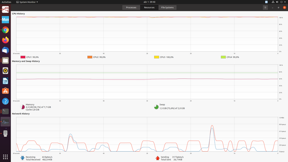

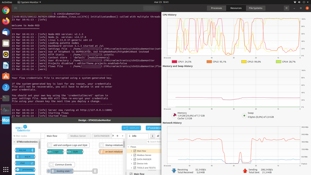

When acq node is started (only after receive start acquisition order) the process allocate 100% of one CPU core.
As shown on the picture below, I'm using at the moment and for development purposes, only two ST-LINK probes, that's why "only" two cores are at 100% allocation.

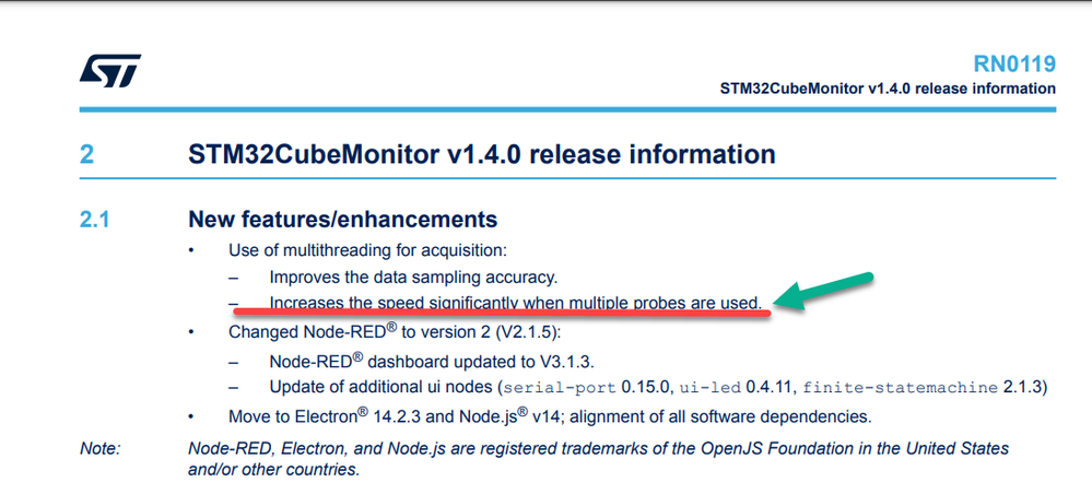

According to V1.4.0 release notes the multiple probe acquisitions was improved.
Windows 10 pro has the same behaviour on V1.3.0 and V1.4.0
Ubuntu 20.04 Desktop has also been tested and verified.

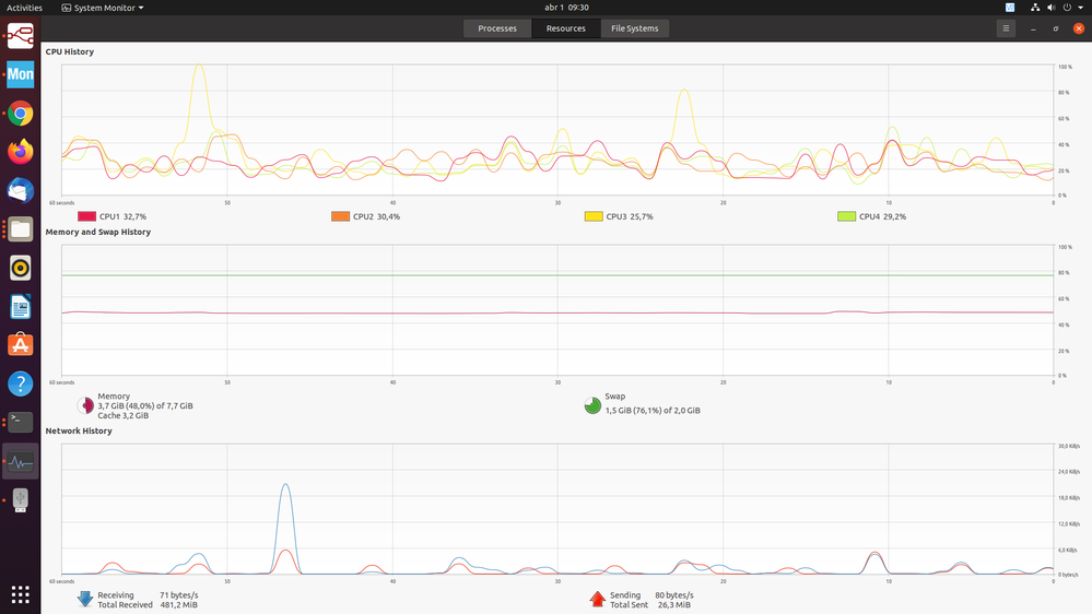

At the moment I have on top of desk a setup wtih 4x ST-LINK V2 getting data at 1Hz each.
With the same flow and HW you can figure out each screenshoot is from V1.3.0 and v1.4.0 cubeMonitor
